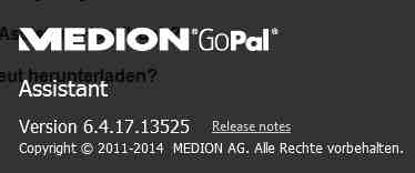

    Es gibt mal wieder eine neue Version vom Medion GoPal-Assistant.
    Medion GoPal Assistant Release Notes
    6.4.17
    • Package-Upgrade through CD-Import now possible (4249)
    • Show the optional GoPal compatibility information for maps (4030)
    • Confirmation dialog is shown when synchronizing packages to device with older versions (4300)
    • Login notifications (4038)
    • My Account Tab (4462)
    • Added S3877 (4478)
    • Improved support for mass-storage-only devices
    • Fixed a inifite login bug when credentials were wrong (4510)
    • Wrong icon was display in popup when login failed (4511)
    • "My Account" page now reloads when tab is clicked (4521)
    • Shop optional info hyperlinks in update dialog (3168)
    • New country selection for tile map (4576)
    • Improved support for ROM-Updates (4579)
    • Assistant will automatically check for updates each time a user logs in or out or a device is connected or disconnected.
    • Added new package feature OVERRIDERULES (4603)
    • Fix a bug in version comparison (4635)
