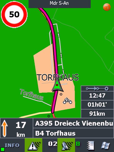

  • Still no go...
    What is going wrong here:
    - Hard reset machine
    - Install MN5 + 5.1 (default location)
    - Install POIwarner 2.91 (default location)
    - Start POI warner and synchronize with TMC and BT numbers skin.
    - Start MN5.1 and it won't work. Icons are missing.
    What am I doing wrong ?
    Can somebody please help me out ?
  • @nomad_nl
    Before starting MN try to activate "Auto-Start" with Datei/ "Allgemeine Einstellungen" (don't forget the "ok"!)
    Then close POI-Warner over Datei/Beenden!
    Then Start MN|5.1.. You have now a little green light in the lower left corner - this means that POI is working automatically.
    You now should have the correct Icons!

  • woooohoooo !
    It's working ! There are still some bmp's which are not in the right place, but I can fix that in the ini files.
    Now let's see how everything looks in Real VGA.
    Thanks to all for the help !
    VGA does not work with default files.
    You have to modify poiwarner.ini and all the bmp files have to be 200% resized.
    In what file is the default pixel position of the TMC icon in the main screen defined ? There now are gaps between the tmc and gps icons.
    Einmal editiert, zuletzt von nomad_nl ()
