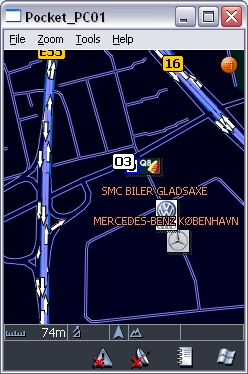

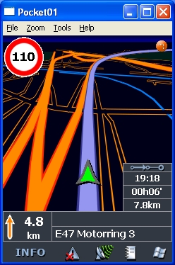

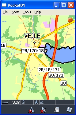

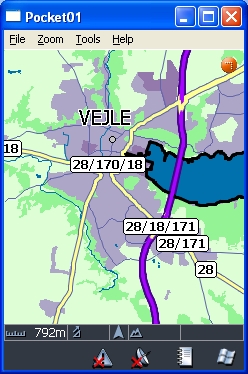

  • Hi. First I am sorry for speeking English in a German forum and thank you for a great site. I come from "Danemark" and have made some Map Styles you may like to use.
    Please feel free to comment the styles (In German if you like - I get it translated)
    Regards Henrik Olsen (heol)
  • And some pictures:
