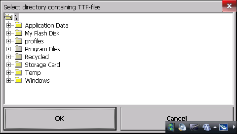

  • Hi Ralf,
    I used your files but I again received the underneath message:
    [Blockierte Grafik: http://i207.photobucket.com/albums/bb131/brucetheboss/message.jpg]

  • What happens if you start the RestoreFonts.exe?
  • I can't believe it! ?( Try it with testing out on other pathes just beneath \MFD or \SD. I'd tested it several times on my PNA and it worked well.
  • I placed the restorefonts files on other place (sd and MFD) and then the *.exe file works (I receive the message as before but I don't receive a message when the files placed in the directory \mortscript)

  • Hi @Panik
    I did what you recommended (resorefonts.exe and after that restorefonts.mscr) but I get again the message that there is no application associated ...........
    The strange thing is that when I place the two files in another directory and then double click on restorefonts.exe I get the above message but when I place the files in the mortscript directory I don't get a message ......... ?
