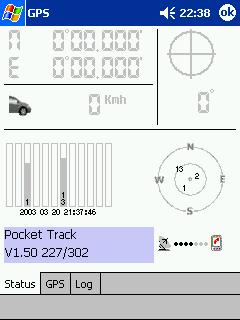

meine Fortuna Pocket Track CF Card empfängt leider nur 2 Satelliten... getestet mit iPAQ 3870 (CF-Jacket) und Jornada 568.
Gilt es irgendetwas zu beachten?
Habe nur die nackte Karte, ohne Handbuch oder Treiber.
Ich bin für jeden Hinweis dankbar ![]()

Da tut sich leider nicht sonderlich viel... TomTom GPS scheint ja irgendwas zu empfangen.

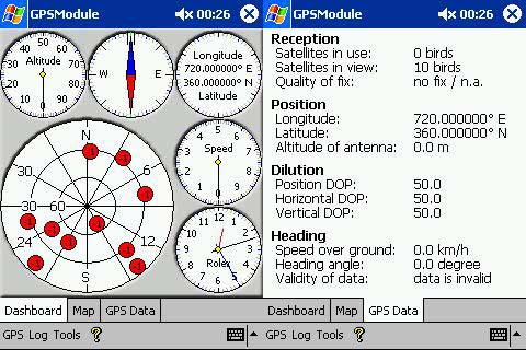

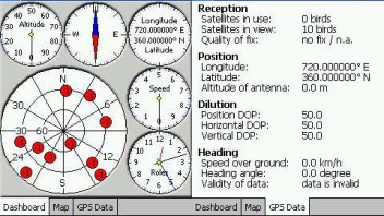

Dank GPS Dash konnte ich nun zumindest schonmal eine Log-Datei erstellen...
Könnt ihr damit etwas anfangen?
ZitatAlles anzeigen$GPGGA,232537.994,36000.0000,N,72000.0000,E,0,00,50.0,0.0,M,,M,,0000*40
$GPGLL,36000.0000,N,72000.0000,E,232537.994,V*15
$GPRMC,232537.994,V,36000.0000,N,72000.0000,E,,,210303,,*21
$GPGGA,232538.994,36000.0000,N,72000.0000,E,0,00,50.0,0.0,M,,M,,0000*4F
$GPGLL,36000.0000,N,72000.0000,E,232538.994,V*1A
$GPRMC,232538.994,V,36000.0000,N,72000.0000,E,,,210303,,*2E
$GPGGA,232539.994,36000.0000,N,72000.0000,E,0,00,50.0,0.0,M,,M,,0000*4E
$GPGLL,36000.0000,N,72000.0000,E,232539.994,V*1B
$GPGSA,A,1,,,,,,,,,,,,,50.0,50.0,50.0*05
$GPGSV,3,1,10,31,69,331,,03,48,028,,02,47,056,,11,33,183,*7B
$GPGSV,3,2,10,27,29,318,,13,29,258,,01,27,217,,16,26,075,*7A
$GPGSV,3,3,10,15,10,042,,08,08,320,*7A
$GPRMC,232539.994,V,36000.0000,N,72000.0000,E,,,210303,,*2F
$GPGGA,232540.994,36000.0000,N,72000.0000,E,0,00,50.0,0.0,M,,M,,0000*40
$GPGLL,36000.0000,N,72000.0000,E,232540.994,V*15
$GPRMC,232540.994,V,36000.0000,N,72000.0000,E,,,210303,,*21
$GPGGA,232541.994,36000.0000,N,72000.0000,E,0,00,50.0,0.0,M,,M,,0000*41
$GPGLL,36000.0000,N,72000.0000,E,232541.994,V*14
$GPRMC,232541.994,V,36000.0000,N,72000.0000,E,,,210303,,*20
$GPGGA,232542.994,36000.0000,N,72000.0000,E,0,00,50.0,0.0,M,,M,,0000*42
$GPGLL,36000.0000,N,72000.0000,E,232542.994,V*17
$GPRMC,232542.994,V,36000.0000,N,72000.0000,E,,,210303,,*23
$GPGGA,232543.994,36000.0000,N,72000.0000,E,0,00,50.0,0.0,M,,M,,0000*43
$GPGLL,36000.0000,N,72000.0000,E,232543.994,V*16
$GPRMC,232543.994,V,36000.0000,N,72000.0000,E,,,210303,,*22
$GPGGA,232544.994,36000.0000,N,72000.0000,E,0,00,50.0,0.0,M,,M,,0000*44
$GPGLL,36000.0000,N,72000.0000,E,232544.994,V*11
$GPRMC,232544.994,V,36000.0000,N,72000.0000,E,,,210303,,*25
$GPGGA,232545.994,36000.0000,N,72000.0000,E,0,00,50.0,0.0,M,,M,,0000*45
$GPGLL,36000.0000,N,72000.0000,E,232545.994,V*10
$GPRMC,232545.994,V,36000.0000,N,72000.0000,E,,,210303,,*24
$GPGGA,232546.994,36000.0000,N,72000.0000,E,0,00,50.0,0.0,M,,M,,0000*46
$GPGLL,36000.0000,N,72000.0000,E,232546.994,V*13
$GPRMC,232546.994,V,36000.0000,N,72000.0000,E,,,210303,,*27
$GPGGA,232547.994,36000.0000,N,72000.0000,E,0,00,50.0,0.0,M,,M,,0000*47
$GPGLL,36000.0000,N,72000.0000,E,232547.994,V*12
$GPRMC,232547.994,V,36000.0000,N,72000.0000,E,,,210303,,*26
$GPGGA,232548.994,36000.0000,N,72000.0000,E,0,00,50.0,0.0,M,,M,,0000*48
$GPGLL,36000.0000,N,72000.0000,E,232548.994,V*1D
$GPRMC,232548.994,V,36000.0000,N,72000.0000,E,,,210303,,*29
$GPGGA,232549.994,36000.0000,N,72000.0000,E,0,00,50.0,0.0,M,,M,,0000*49
$GPGLL,36000.0000,N,72000.0000,E,232549.994,V*1C
$GPRMC,232549.994,V,36000.0000,N,72000.0000,E,,,210303,,*28
$GPGGA,232550.994,36000.0000,N,72000.0000,E,0,00,50.0,0.0,M,,M,,0000*41
$GPGLL,36000.0000,N,72000.0000,E,232550.994,V*14
$GPRMC,232550.994,V,36000.0000,N,72000.0000,E,,,210303,,*20
$GPGGA,232551.994,36000.0000,N,72000.0000,E,0,00,50.0,0.0,M,,M,,0000*40
$GPGLL,36000.0000,N,72000.0000,E,232551.994,V*15
$GPRMC,232551.994,V,36000.0000,N,72000.0000,E,,,210303,,*21
$GPGGA,232552.993,36000.0000,N,72000.0000,E,0,00,50.0,0.0,M,,M,,0000*44
$GPGLL,36000.0000,N,72000.0000,E,232552.993,V*11
$GPRMC,232552.993,V,36000.0000,N,72000.0000,E,,,210303,,*25
$GPGGA,232553.993,36000.0000,N,72000.0000,E,0,00,50.0,0.0,M,,M,,0000*45
$GPGLL,36000.0000,N,72000.0000,E,232553.993,V*10
$GPRMC,232553.993,V,36000.0000,N,72000.0000,E,,,210303,,*24
$GPGGA,232554.993,36000.0000,N,72000.0000,E,0,00,50.0,0.0,M,,M,,0000*42
$GPGLL,36000.0000,N,72000.0000,E,232554.993,V*17
$GPRMC,232554.993,V,36000.0000,N,72000.0000,E,,,210303,,*23
$GPGGA,232555.993,36000.0000,N,72000.0000,E,0,00,50.0,0.0,M,,M,,0000*43
$GPGLL,36000.0000,N,72000.0000,E,232555.993,V*16
$GPRMC,232555.993,V,36000.0000,N,72000.0000,E,,,210303,,*22
$GPGGA,232556.993,36000.0000,N,72000.0000,E,0,00,50.0,0.0,M,,M,,0000*40
$GPGLL,36000.0000,N,72000.0000,E,232556.993,V*15
$GPRMC,232556.993,V,36000.0000,N,72000.0000,E,,,210303,,*21
$GPGGA,232557.993,36000.0000,N,72000.0000,E,0,00,50.0,0.0,M,,M,,0000*41
$GPGLL,36000.0000,N,72000.0000,E,232557.993,V*14
$GPRMC,232557.993,V,36000.0000,N,72000.0000,E,,,210303,,*20
$GPGGA,232558.993,36000.0000,N,72000.0000,E,0,00,50.0,0.0,M,,M,,0000*4E
$GPGLL,36000.0000,N,72000.0000,E,232558.993,V*1B
$GPRMC,232558.993,V,36000.0000,N,72000.0000,E,,,210303,,*2F
$GPGGA,232559.993,36000.0000,N,72000.0000,E,0,00,50.0,0.0,M,,M,,0000*4F
$GPGLL,36000.0000,N,72000.0000,E,232559.993,V*1A
$GPRMC,232559.993,V,36000.0000,N,72000.0000,E,,,210303,,*2E
$GPGGA,232600.993,36000.0000,N,72000.0000,E,0,00,50.0,0.0,M,,M,,0000*40
$GPGLL,36000.0000,N,72000.0000,E,232600.993,V*15
$GPRMC,232600.993,V,36000.0000,N,72000.0000,E,,,210303,,*21
$GPGGA,232601.993,36000.0000,N,72000.0000,E,0,00,50.0,0.0,M,,M,,0000*41
$GPGLL,36000.0000,N,72000.0000,E,232601.993,V*14
$GPRMC,232601.993,V,36000.0000,N,72000.0000,E,,,210303,,*20
$GPGGA,232602.993,36000.0000,N,72000.0000,E,0,00,50.0,0.0,M,,M,,0000*42
$GPGLL,36000.0000,N,72000.0000,E,232602.993,V*17
$GPRMC,232602.993,V,36000.0000,N,72000.0000,E,,,210303,,*23
$GPGGA,232603.993,36000.0000,N,72000.0000,E,0,00,50.0,0.0,M,,M,,0000*43
$GPGLL,36000.0000,N,72000.0000,E,232603.993,V*16
$GPRMC,232603.993,V,36000.0000,N,72000.0000,E,,,210303,,*22
$GPGGA,232604.993,36000.0000,N,72000.0000,E,0,00,50.0,0.0,M,,M,,0000*44
$GPGLL,36000.0000,N,72000.0000,E,232604.993,V*11
$GPRMC,232604.993,V,36000.0000,N,72000.0000,E,,,210303,,*25
$GPGGA,232605.993,36000.0000,N,72000.0000,E,0,00,50.0,0.0,M,,M,,0000*45
$GPGLL,36000.0000,N,72000.0000,E,232605.993,V*10
$GPRMC,232605.993,V,36000.0000,N,72000.0000,E,,,210303,,*24
$GPGGA,232606.993,36000.0000,N,72000.0000,E,0,00,50.0,0.0,M,,M,,0000*46
$GPGLL,36000.0000,N,72000.0000,E,232606.993,V*13
$GPRMC,232606.993,V,36000.0000,N,72000.0000,E,,,210303,,*27
$GPGGA,232607.992,36000.0000,N,72000.0000,E,0,00,50.0,0.0,M,,M,,0000*46
$GPGLL,36000.0000,N,72000.0000,E,232607.992,V*13
$GPRMC,232607.992,V,36000.0000,N,72000.0000,E,,,210303,,*27
$GPGGA,232608.992,36000.0000,N,72000.0000,E,0,00,50.0,0.0,M,,M,,0000*49
$GPGLL,36000.0000,N,72000.0000,E,232608.992,V*1C
$GPRMC,232608.992,V,36000.0000,N,72000.0000,E,,,210303,,*28
$GPGGA,232609.992,36000.0000,N,72000.0000,E,0,00,50.0,0.0,M,,M,,0000*48
$GPGLL,36000.0000,N,72000.0000,E,232609.992,V*1D
$GPRMC,232609.992,V,36000.0000,N,72000.0000,E,,,210303,,*29
$GPGGA,232610.992,36000.0000,N,72000.0000,E,0,00,50.0,0.0,M,,M,,0000*40
$GPGLL,36000.0000,N,72000.0000,E,232610.992,V*15
$GPRMC,232610.992,V,36000.0000,N,72000.0000,E,,,210303,,*21
$GPGGA,232611.992,36000.0000,N,72000.0000,E,0,00,50.0,0.0,M,,M,,0000*41
$GPGLL,36000.0000,N,72000.0000,E,232611.992,V*14
$GPRMC,232611.992,V,36000.0000,N,72000.0000,E,,,210303,,*20
$GPGGA,232612.992,36000.0000,N,72000.0000,E,0,00,50.0,0.0,M,,M,,0000*42
$GPGLL,36000.0000,N,72000.0000,E,232612.992,V*17
$GPRMC,232612.992,V,36000.0000,N,72000.0000,E,,,210303,,*23
$GPGGA,232613.992,36000.0000,N,72000.0000,E,0,00,50.0,0.0,M,,M,,0000*43
$GPGLL,36000.0000,N,72000.0000,E,232613.992,V*16
$GPRMC,232613.992,V,36000.0000,N,72000.0000,E,,,210303,,*22
$GPGGA,232614.992,36000.0000,N,72000.0000,E,0,00,50.0,0.0,M,,M,,0000*44
$GPGLL,36000.0000,N,72000.0000,E,232614.992,V*11
$GPRMC,232614.992,V,36000.0000,N,72000.0000,E,,,210303,,*25
$GPGGA,232615.992,36000.0000,N,72000.0000,E,0,00,50.0,0.0,M,,M,,0000*45
$GPGLL,36000.0000,N,72000.0000,E,232615.992,V*10
$GPRMC,232615.992,V,36000.0000,N,72000.0000,E,,,210303,,*24
$GPGGA,232616.992,36000.0000,N,72000.0000,E,0,00,50.0,0.0,M,,M,,0000*46
$GPGLL,36000.0000,N,72000.0000,E,232616.992,V*13
$GPRMC,232616.992,V,36000.0000,N,72000.0000,E,,,210303,,*27
$GPGGA,232617.992,36000.0000,N,72000.0000,E,0,00,50.0,0.0,M,,M,,0000*47
$GPGLL,36000.0000,N,72000.0000,E,232617.992,V*12
$GPRMC,232617.992,V,36000.0000,N,72000.0000,E,,,210303,,*26
$GPGGA,232618.992,36000.0000,N,72000.0000,E,0,00,50.0,0.0,M,,M,,0000*48
$GPGLL,36000.0000,N,72000.0000,E,232618.992,V*1D
$GPRMC,232618.992,V,36000.0000,N,72000.0000,E,,,210303,,*29
$GPGGA,232619.992,36000.0000,N,72000.0000,E,0,00,50.0,0.0,M,,M,,0000*49
@Wigald
Nun gut, Du hast also Empfang ! Super ! (GGA,GGL und RMC)
Jetzt solltest Du noch das GSV-Protokoll (und GSA) dazuprogrammieren und schon sollte es geh'n.
LG
Roland
Jetzt scheint die Karte endlich mit "GPS-Maus" kommunizieren zu können... aktivierte Protokolle werden sofort ausgegeben ![]()
Am Empfang hat sich leider wenig geändert, die auf dem Screenshot angezeigte Position ist doch irgendwie ungewöhnlich ![]()
ZitatFortuna PocketTrack CF GPS receiver
WAAS(Wide Area Augmentation System) demodulator
Ist WAAS evtl. noch aktiviert? Wenn ja, womit deaktiviert man es?
Hilft mir die Reset-Option von "GPS-Maus" evtl. weiter? (z.B. Factory Reset)
Fragen über Fragen... ![]()
@Wigald
Naja da gibt es noch Tastaturtreiber für ext. Tastatur und den Infrarot Port, den man deaktivieren muß.
LG
Roland
ZitatOriginal von KalliR
@Wigald
LG
Roland
Nix für ungut, aber gemäß dem NMEA-Protokoll hat Wigald ÜBERHAUPT KEINEN Empfang, ich weiss nicht, woraus Du hier Empfang ableitest.
Schauen wir uns mal z.B. eine GPGGA-Zeile aus Wigald's Posting an:
Interessant vor allem sind die Zahlen, die nach dem 'E' kommen, nämlich 0,00,50.0 . Das heißt: Die erste 0 besagt, daß die Messung nicht gültig ist, die zweite 00 ist die Anzahl benutzter Satelliten (nämlich 0 ) und der Wert von 50.0 ist der Fehler (HDOP), wobei 50.0 der maximale Fehlerwert ist (=schlechter geht's nicht).
Die ausgegebenen Koordinaten 36,0000° N, 72,0000° E halte ich für Default-Werte, aber wohl kaum für eine echte Messung. (es sei denn, Wigald hält sich gerade im Westen Pakistans auf...).
Da alle Messungen im Protokoll mit 0 Satelliten vermerkt sind, würde ich sagen, daß der GPS-Empfänger entweder keine freie Himmelssicht hat oder - wohl eher- defekt ist.
@vossi
Mit "Empfang" meinte ich, dass er die richtige Serielle-konfig. zur GPS-Maus gefunden hat.
Wenn er jetzt die Maus im Freien für 30-40min laufen lässt und er dann noch immer keine "Positionsdaten" empfangen kann, dann bin ich auch der Meinung, dass die GPS-Maus defekt ist.
LG
Roland
