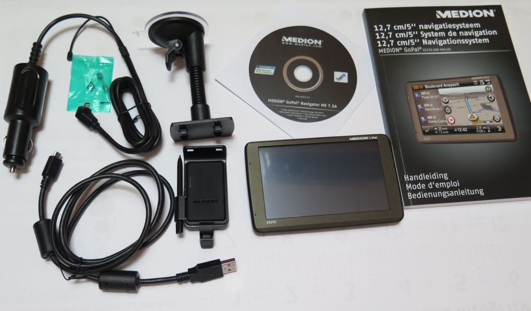

    So, ich habe das Gerät jetzt bei Aldi Belgien gekauft (deshalb Handbuch in DE-FR-NL).
    Zur allgemeinen Info hier ein Foto des Paketinhaltes (Medion E5270 - Aldi MD99425).
    Zusätzlich war noch ein Gutschein zum Kartenupdate dabei, Gültigkeit bis 30.9.2017.

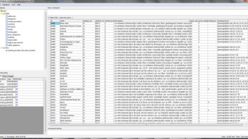

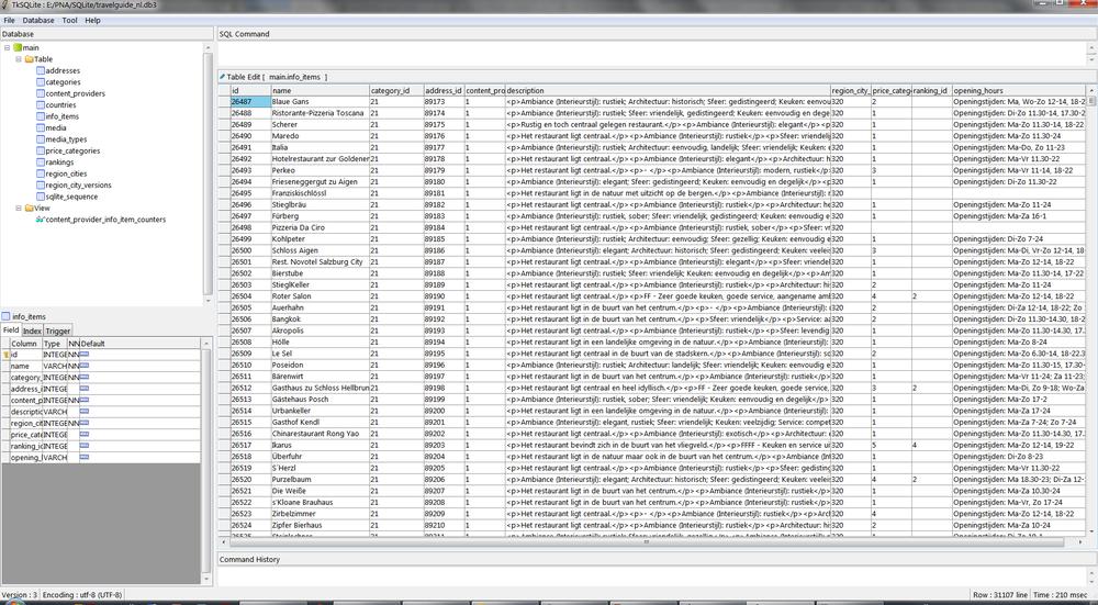

  • Well, on my DVD there is a "dutch-named" *.cab in \INSTALL\4\travelguide_data_xxxxxxxxx_nl_x.cab. Did you guys make sure to have it installed in this version? :denk_002:
    If so you should find the DB-File (SQLite) in -> \My Flash Disk\Navigation\multimedia\travelguide\content\database\travelguide_nl.db3. And of course, all the content, categories and items in the database is in Dutch, check my shot below. :top_002:
    And you're sure this scenario doesn't work on a properly installed pna? :denk_002:
    You can check the travelguide_nl.db3 e.g. with this frontend here: http://reddog.s35.xrea.com/wiki/TkSQLite.html
  • Thank you for your help!
    The file travelguide_nl.db3 was installed, but apparently there was a bug...
    I had to insist before Medion acknowledged the problem, but finally, they sent another file travelguide_nl.db3 to replace the one installed on the device, so it works.
