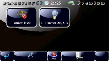

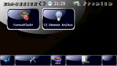

II: Die Realisierung mit MortScript
A:
Allgemeine Lösung
# CE_DIMMER_PROMPT.mscr
# 2009-09-12
# jwoegerbauer
# GNU General Public License (GPL), Version 2, June 1991
# Notes:
# This script is temporarily
# overriding these registry settings
# [HKEY_LOCAL_MACHINE\System\CurrentControlSet\Control\Power]
# "BattPowerOff"=dword:00000000
# "ExtPowerOff"=dword:00000000
# [HKEY_LOCAL_MACHINE\System\CurrentControlSet\Control\Power\Timeouts]
# "ACUserIdle"=dword:00000001
# "BattUserIdle"=dword:00000001
# The ini-template to be used
# ;CeDimmer.ini
# [UserIdle]
# BattUserIdle=0
# ACUserIdle=0
# [PowerOff]
# BattPowerOff=0
# ExtPowerOff=0
# [Installation]
# DeActivated=0
# StandardVals=0

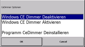

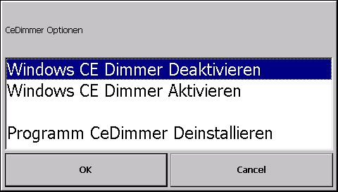

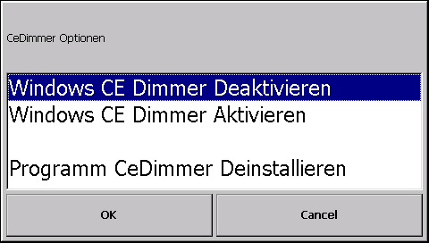

options[1] = "Windows CE Dimmer Deaktivieren"
options[2] = "Windows CE Dimmer Aktivieren"
options[3] = " "
options[4] = "Programm CeDimmer Deinstallieren"
Sleep 100
# present dialogue to user
SetChoiceEntryFormat(%lineHeight%, %fontSize%, %fontName%)
Choice("CeDimmer Optionen", \
"^NL^^NL^CeDimmer Optionen^NL^^NL^", options)
