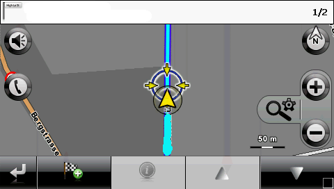

I see that it is saving the position of de crosshair position and *not* the "actual" position ........Am I correct ?

But I see that it is saving the position of de crosshair position and *not* the "actual" position ........Am I correct ?

Hi
put the crosshair over the actual position and push the button

I knew that this would be the solution and of course it goes a lot faster than the traditional way
