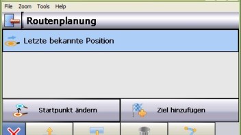

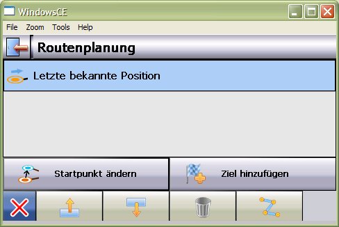

  • Hi Werner!
    This position is the home of the GoPal developpers and it is IMO fix coded in the mnavdce.exe and can't be changed in any config file. :-D)
    But after having calculated a route (without getting a sat-fix) you've got the possibility within the dialog "Route planning" (see below) to change the "starting point" (in german: "Startpunkt ändern") just like another destination. This perhaps may help you.
