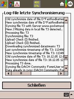

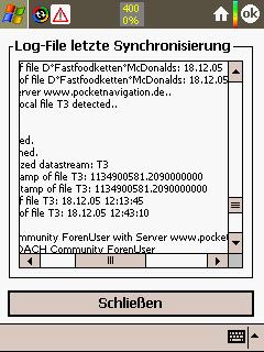

    das Log sagt volgendes dazu:
    Syncing file T3 with Server www.pocketnavigation.de..
    New / Missing data in local file T3 detected..
    Processing file: T3
    Synchronizing file: T3
    Upload Check (I) finished.
    Upload Check (II) finished.
    Downloading synchronized datastream: T3
    Last synchronize timestamp of file T3: 1134918940.5530000000
    New synchronize timestamp of file T3: 1134918940.5530000000
    Old synchronize date of file T3: 19.12.05 12:51:17
    New synchronize date of file T3: 19.12.05 12:55:14
    Processing T3 done.
