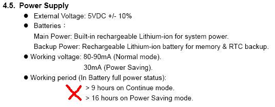

    with automatic shut off system power after ten minutes
    non connecting to any Bluetooth device.
    Carsten,
    das fand ich in den Specs.
    Klingt eigenartig, oder? (sind genau Deine 10 Min)
