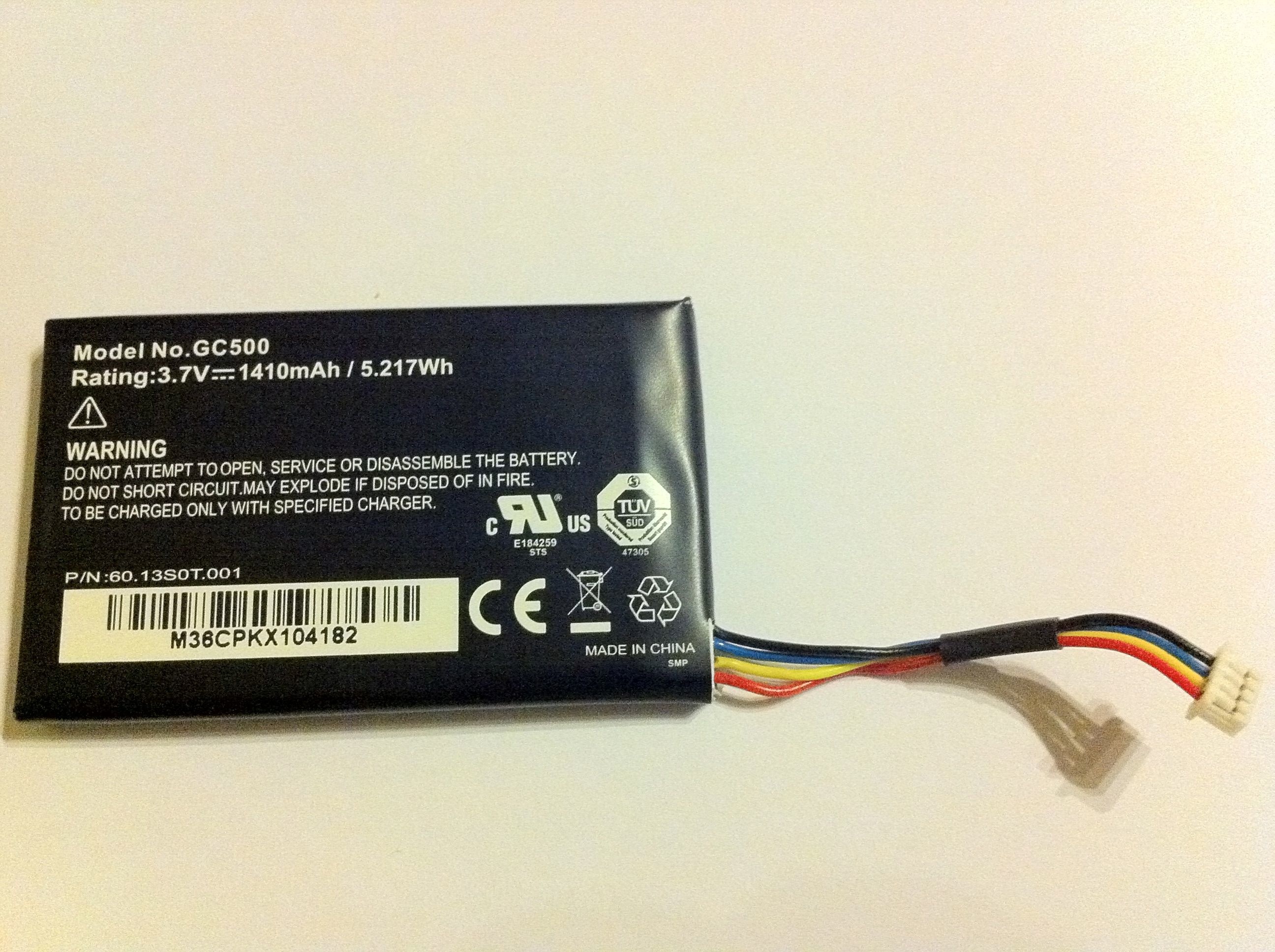

  • Hallo
    Ich spreche kein Deutsch
    Ich benutze Google Translate
    wo finde ich den Akku für 8410 ?
    Original Akku Informationen :
    Model No.GC500
    Rating: 3.7V 1410mAh...
    .....P/N:60.13S0T.001...
    Bar code : M36CPKX104182
    Ich habe nichts bei google gefunden!
    Batterien sind kompatibel?
    Dank
    Fabio
    p.s. antworten Sie bitte Englisch

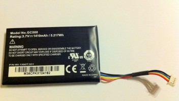

    I disassembled 8410 and first off all i disconnected battery plug to avoid any damage.
    here in an image
    Measures are: Large 35 mm ; Length 58 mm ; Height 4 mm
    I tried everything to find any compatible type but no result.
    I saw Optoma battery but they do not report measures and it is very expensive only to try (cost is about 50 euros)
    I found in this website a battery that look like that one for 8410; it is for Magellan Roadmate 1200: connector seem equal (four wires red-yellow-blue-black)
    Here is the link: "http://www.batterymart.com/p-pda-279li-magellan-battery.html?Category_Code=magellan-384-00015-005-gps"
    What do you think ?
    Regards
    Fabio
