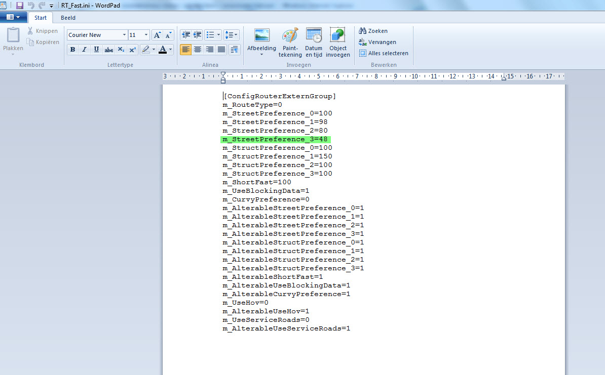

  • Nr. 1:
    Change de routing (Navigon/settings/routing).
    I had this problem also in South_France, what a mess.
    I changed RT_fast.ini and RT_optimum.ini.
    Open these files with a simply wordeditor en look for:
    m-StreetPreference_3=
    Change the value into 48 (see attachment)
    Now the most of that kind of problems are solved. Try it and if you don't like it restore the value.
