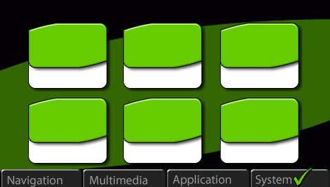

Made some skins for the green-2 theme (looks almost original)
If anyone is interested, I can upload the files. Please let me know. -
Ok Whizzy I am interested
Original von manduria
Ok Whizzy I am interestedHere it is:
http://www.megaupload.com/nl/?d=NUZ7C80SMade some more changes, removed the menu animations (better performance) and changed the text color in the ini files.
Added 2 icons for non available applications (tomtombw.ico and poibw.ico). They're just greyed out.
Check the navigation.ini for the location of the executables igo8.exe and mobilenavigator.exe The names and locations have to be in the corresponding foldersOf course: change your skin to green-2
Just replace the ini.files with the files in the CLOSy-Main folder or, when you used the change skin command, in the main folder.
Replace the bitmaps (bmp) in the Atmos VDO-E-M folderViel erfolg
