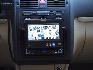

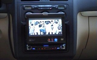

  • Hi Hans-Jörg,
    I have a Touran with an X1 build in. You have to place the X1 at the bottom of the 2-DIN. If the screen is up, the airco buttons are halve covered, but operational.
  • Hi Rogér,
    thanks for this information and the picture! Looks very nice.
    Have you put the blackbox from the AVIC-X1 in the upper of the 2 DIN?
    And why you have choosed the Senergy screens instead of the Pioneer? (price, quality, ..)
    Thanks and nice weekend, Hans-Jörg
  • Hi Hans-Jörg,
    I have the blackbox installed in the area behind the ashtray, there is plenty of room.
    The senergy screens are quite good and very cheap.
    Advantage Senergy:
    * 2 AV channels
    * 300,-- /piece ( 700,--/pc for the AVD-W6200 Pioneer)
    * No separate blackbox
    * only 22 mm thick
    * IR remote controlled
    * Video input at the screen front
    * Headphone connector at screen front
    Have also a nice weekend.
